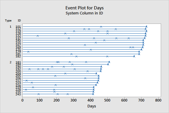

You want to compare two different types of a particular brake component used on a subway train. Your data include replacement times and component type for 29 trains. The final time for each train is the final failure for that train.
1    Open the worksheet TRAIN.MTW.
2    Choose Stat > Reliability/Survival > Repairable System Analysis > Nonparametric Growth Curve.
3    In Variables/Start variables, enter Days.
4    Under System Information, choose System ID, then enter ID.
5    Check By variable, then enter Type.
6    Click OK.

Graph window output
Interpreting the results
Minitab displays nonparametric estimates of the mean cumulative function and its corresponding standard error and confidence limits separately for each group. For example, the mean cumulative function is 0.07143 at 33 days for the first type of train. You can be 95% confident that the true mean cumulative function is between 0.01081 and 0.47218.
Use the mean cumulative difference function to make comparisons across groups. For example, type 2 trains had, on average, 0.06667 more failures at 19 days. Because all of the confidence intervals contain zero, no significant differences exist in the mean cumulative difference function between groups at any given time.
The event plot shows when the failures occurred for each system. Each line extends to the last day of observation. Use this plot to visualize trends within and across groups. Here, system failures are occurring at a constant rate. The first failures occur slightly earlier for the type 1 trains.
The mean cumulative function plot displays the mean cumulative function for each group. From this plot, you can conclude that:
·    The line representing type 2 trains is relatively straight, not curved, up until around 450 days, indicating that the failure rate is remaining relatively constant until that point
·    The line representing type 1 trains is slightly concave up, indicating that the failure rate is slightly increasing
·    The line representing type 1 trains is to the right of the line representing type 2 trains, indicating that failures are occurring less often for type 1 trains
