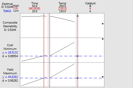

Interpreting the results
The individual desirabilities appear on the response optimization plot. The desirability for Yield is 0.98282 and the individual desirability for Cost is 0.86954. The composite desirability for both of these two variables is 0.924449.
To obtain this desirability, you would set the factor levels at the values shown under Solution in the Session window. That is, time would be set at 46.3636, temperature at 150, and you would use catalyst A.
If you want to try to improve this initial solution, you can use the plot. Move the red vertical bars to change the factor settings and see how the individual desirabilities and the composite desirability change. Click Predict on the graph to calculate the response values for the new solution.
