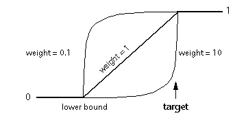

The illustrations below show how the shape of the desirability function changes when the goal is to maximize the response and the weight changes:
Weight
Desirability function
d = desirability
0.1
A weight less than one places less
emphasis on the target. a response
value far from the target may have a
high desirability.
                                            target
A weight equal to one places equal
emphasis on the target and the
bounds. The desirability for a response
increases linearly.
                                        target
A weight greater than one places more
emphasis on the target. A response
value must be very close to the target
to havea high desirability.
                                      target

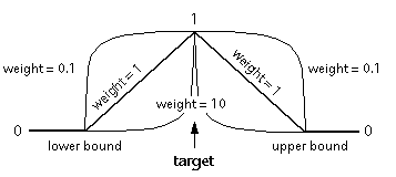

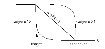

The illustrations below summarize the desirability functions:
When the goal is to ...
minimize the response
Below the target the response desirability is one; above the upper bound it is zero.
target the response
Below the lower bound the response desirability is zero;
at the target it is one; above
Below the lower bound the response desirability is zero; above the target it is one.
