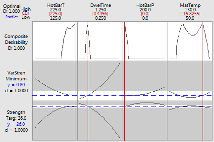

Graph Window Output
Interpreting the results
The individual desirability of both the seal strength and the variance in seal strength is 1.0. Therefore, the combined or composite desirability of these two variables is 1.0.
To obtain this desirability, you would set the factor levels at the values shown under Solution. That is, hot bar temperature would be set at 225.000, dwell time at 0.449575, hot bar pressure at 0, and material temperature at 115.826.
If you want to adjust the factor settings of this initial solution, you can use the plot. Move the vertical bars to change the factor settings and see how the individual desirability of the responses and the composite desirability change. For example, you may want see if you can reduce the material temperature (which would save money) and still meet the product specifications.
