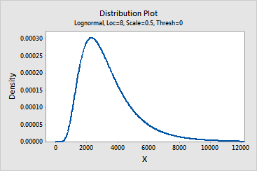

Example of a single probability distribution plot

Suppose you are analyzing the distribution of operational hours for a machine part. Previous company research suggests that a lognormal distribution with a location of 8, scale of 0.5, and a threshold of 0 models the data well. To visualize this distribution, you use Probability Distribution Plot.
1    Choose Graph > Probability Distribution Plot.
2    Choose View Single, then click OK.
3    From Distribution, choose Lognormal.
4    In Location, type 8.
5    In Scale, type 0.5.
6    Click OK.
Graph window output
Interpreting the results
The distribution curve helps you visualize a lognormal distribution with the specified parameters. For the machine part, life span probability appears to peak at approximately 2300 hours. However, most parts will last longer than 2300 hours with a few lasting many times that. It is highly unlikely that a part will last less than 400 hours.
