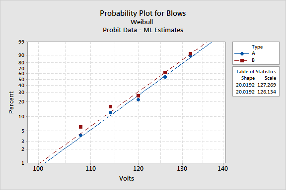

Graph window output:
Interpreting the results
The goodness-of-fit tests (p-values = 0.926, 0.928) and the probability plot suggest that the Weibull distribution fits the data adequately. Since the test for equal slopes is not significant (p-value = .611), the comparison of light bulbs will be similar regardless of the voltage level. In this case, the light bulbs A and B are not significantly different because the coefficient associated with type B is not significantly different than 0 (p-value = .262).
At 117 volts, what percentage of the bulbs lasts beyond 800 hours? Eight-three percent of the bulb A's and 80% of the bulb B's last beyond 800 hours.
At what voltage do 50% of the bulbs fail before 800 hours? The table of percentiles shows you that 50% of bulb A's fail before 800 hours at 124.96 volts; 50% of bulb B's fail before 800 hours at 123.85 volts.
