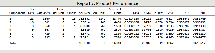

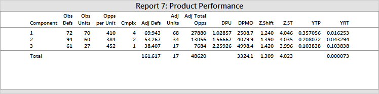

Suppose you wish to use the Product Report to perform successive rollups in order to determine the overall performance measures for a complex product. In this example, assume you have a product composed of 3 assemblies:
·    Assembly 1 requires 2 units of subassembly 1-1 and 1 unit of subassembly 1-2.
·    Assembly 2 requires 4 units of subassembly 2-1, 2 units of subassembly 2-2, and 1 unit of subassembly 2-3.
·    Assembly 3 requires 1 unit of subassembly 3-1, 1 unit of subassembly 3-2, and 6 units of subassembly 3-3.
The end product requires 4 units of assembly 1, 2 units of assembly 2, and 1 unit of assembly 3.

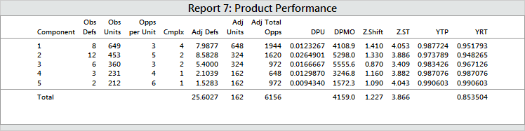

Assembly 1 - Subassembly 1-1
Assembly 1 - Subassembly 1-2

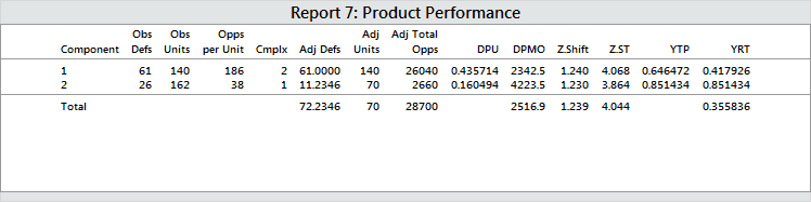

Combine the Product Report data from subassembly 1-1 and subassembly 1-2 to make the report for assembly 1:
Sub-assembly
Defects
Units
Opps/Unit
Z.Shift
 1-1
61
140
26040 / 140 = 186
1.24
 1-2
162
6156 / 162 = 38
1.23
Entire Assembly 1
In the process of making 70 units of assembly 1, there are 72 defects. Overall, assembly 1 has a Z = 4.044 and YRT = 0.3558. In other words, the probability of making one unit of assembly 1 with 0 defects is ~ 36%.

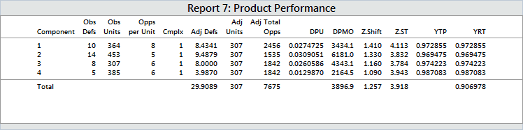

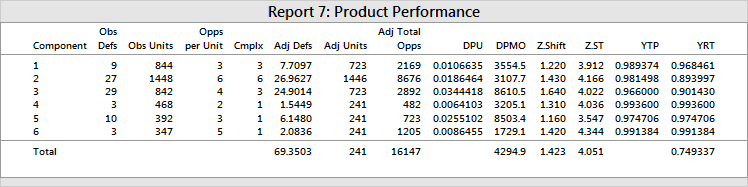

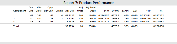

Assembly 2 - Subassembly 2-1
Assembly 2 - Subassembly 2-2
Assembly 2 - Subassembly 2-3
Use the following data to make the report for assembly 2:
Sub-assembly
Defects
Units
Opps/Unit
Z.Shift
 2-1
69
241
16147 / 241 = 67
1.42
 2-2
307
7675 / 307 = 25
1.26
 2-3
36
162
10692 / 162 = 66
1.36
Entire Assembly 2
In the process of making 60 units of assembly 2, there are 94 defects. Overall, assembly 2 has a Z = 4.035 and YRT = 0.2089. In other words, the probability of making one unit of assembly 2 with 0 defects is ~ 21%.

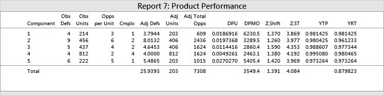

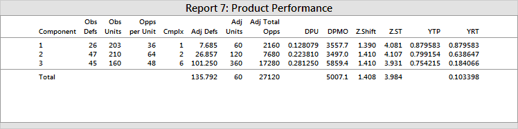

Assembly 3 - Subassembly 3-1
Assembly 3 - Subassembly 3-2
Assembly 3 - Subassembly 3-3
Use the following data to make the report for assembly 3:
Sub-assembly
Defects
Units
Opps/Unit
Z.Shift
 3-1
203
7308 / 203 = 36
1.39
 3-2
47
210
13440 / 210 = 64
1.41
 3-3
45
160
7680 / 160 = 48
1.42
Entire Assembly 3
In the process of making 60 units of assembly 3, there are 136 defects. Overall, assembly 3 has a Z = 3.984 and YRT = 0.1034. In other words, the probability of making one unit of assembly 3 with 0 defects is ~ 10%.
Entire Product
You would expect to see 162 defects in 17 products. The entire product has a Z = 4.023 and YRT = 0.000073. This means that the probability of producing an entire product with 0 defects is essentially 0. Considering the large opportunity count (48620 total opportunities divided by 17 products is 2860 opportunities per product) and the Z of 4, this is to be expected.
The three assemblies are almost identical in capability, with Z values very close to 4.
