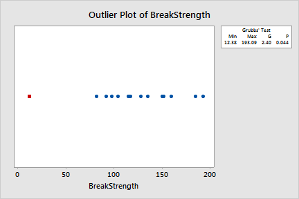

Graph window output
Interpreting the results
The results for the broom handle data show that the mean of the sample is 123.4. The G statistic indicates that  the smallest data value, 12.38, is 2.4 standard deviations less than the mean. The p-value indicates that, if all values are truly from the same, normally distributed population, then the probability of obtaining a minimum value that small is only 0.044. This p-value is less than your chosen significance level, so you can reject the null hypothesis and conclude that the smallest value is an outlier.
You investigate further and discover that the person who entered the data accidentally entered 12.38 instead of 123.8.
