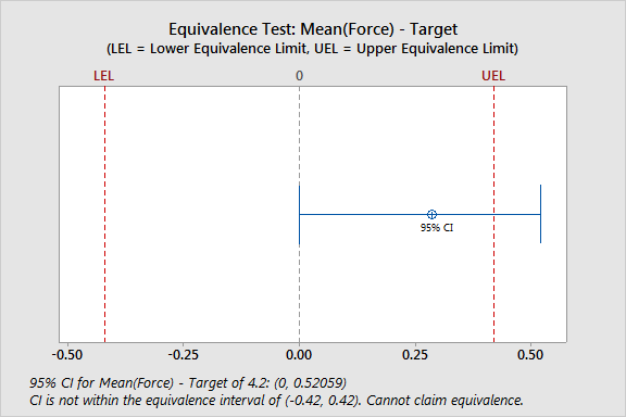

Graph window output
Interpreting the results
For the snack bag data, the confidence interval for the difference is not completely within the equivalence interval. Thus you cannot conclude that the force that is required to open the new bags is equivalent to the target of 4.2 N.
