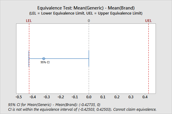

Graph window output
Interpreting the results
Note
You should not evaluate equivalence if either the carryover effect or the period effect is significant. If either effect is significant, then the equivalence results may be unreliable.
The p-value for the carryover effect (0.498) and the p-value for the period effect (0.128) are both greater than 0.05. Thus these effects are not significant at the 0.05 level.
The p-value for the treatment effect (0.000) is less than 0.05. Thus the treatment effect is significant at the 0.05 level. The significant treatment effect indicates that one antacid is better than the other at raising stomach pH. The generic antacid did not raise stomach pH as much as the brand-name antacid. The mean stomach pH after the generic antacid was approximately -0.321 less than the average pH after the brand-name antacid.
The difference table and the equivalence plot show that the confidence interval for the difference (-0.42735, 0) falls partly outside of the equivalence interval (-0.42503, 0.42503). Thus you cannot claim that the two antacids are equally effective at raising stomach pH.
