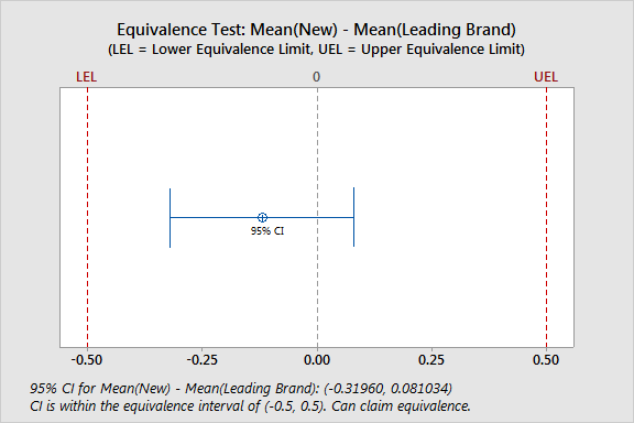

Graph window output
Interpreting the results
For the contact lens data, the confidence interval for the difference is completely within the equivalence interval. Thus you can conclude that both cleaning solutions are equally effective at cleaning contact lenses.
