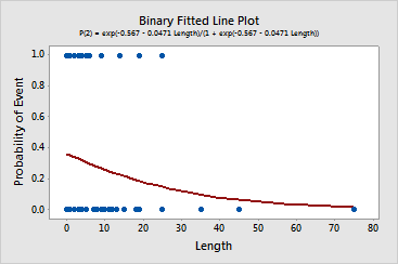

Binary Fitted Line: Reason versus Length
* WARNING * When the data are in the Response/Frequency format, the Residuals versus fits
            plot is unavailable.
Binary Fitted Line Plot
Method
Link function  Logit
Rows used      58
Response Information
Variable  Value  Count
Reason    2         16  (Event)
          1         42
          Total     58
Deviance Table
Source      DF  Adj Dev  Adj Mean  Chi-Square  P-Value
Regression   1    2.333     2.333        2.33    0.127
  Length     1    2.333     2.333        2.33    0.127
Error       56   65.991     1.178
Total       57   68.324
Model Summary
Deviance   Deviance
    R-Sq  R-Sq(adj)    AIC
   3.41%      1.95%  69.99
Coefficients
Term         Coef  SE Coef   VIF
Constant   -0.567    0.396
Length    -0.0471   0.0366  1.00
Odds Ratios for Continuous Predictors
        Odds Ratio       95% CI
Length      0.9539  (0.8879, 1.0249)
Regression Equation
P(2) = exp(-0.567 - 0.0471 Length)/(1 + exp(-0.567 - 0.0471 Length))

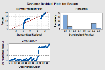

Deviance Residual Plots for Reason

Plots: In the example, you chose three diagnostic plots. These plots do not reveal any points that deviate from the rest of the data, although you can see that observation 58 has the largest residual. Because other discharges are rare, the model predicts higher probabilities that the hospital discharged patients for normal reasons. When the hospital discharged a patient for other reasons, the residuals are farther from zero than when the hospital discharged a patient for normal reasons.
The residuals do not follow a normal distribution. Therefore, the confidence intervals on the binary fitted line plot are unreliable.
The binary fitted line plot shows that the relationship between length of stay and reason for discharge is weak.
