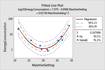

Fitted Line: EnergyConsumption versus MachineSetting
Graph window output
Interpreting the results
The quadratic model (p-value = 0.000, or actually p-value < 0.0005) appears to provide a good fit to the data. The R indicates that machine setting accounts for 93.1% of the variation in log10 of the energy consumed. A visual inspection of the plot reveals that the data are randomly spread about the regression line, implying no systematic lack-of-fit. The 95% confidence limits (95% CI) for the log10 of energy consumed and the 95% prediction limits (95% PI) for new observations are also shown.
