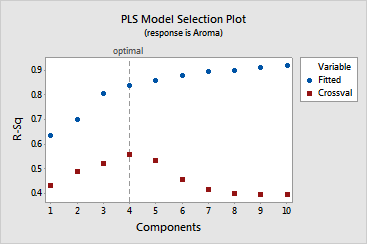

· The
model selection plot is a graphical display of the Model Selection and
Validation table. The vertical line indicates that the optimal model has
four components. You can see that the predictive ability of all models
with more than four components decreases significantly.

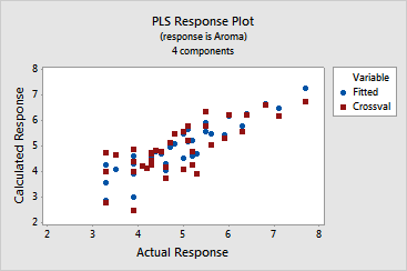

· The
response plot indicates that the model fits the data adequately because
the points are in a linear pattern, from the bottom left-hand corner to
the top right-hand corner. Although there are differences between the
fitted
and cross-validated fitted responses,
none are severe enough to indicate an extreme leverage
point.

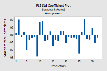

· The
coefficient plot displays the standardized coefficients
for the predictors. You can use this plot to interpret the magnitude and
sign of the coefficients. The elements Mo, Cu, Sr, Pb, B, Ca, Cd*Sr, Cd*B
have the largest standardized coefficients and the biggest impact on aroma.
The elements Mo, Pb, B, and Cd*B are positively related to aroma, while
Cu, Sr, Ca, and Cd*Sr are negatively related.

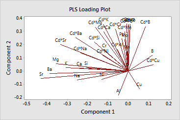

· The
loading plot compares the relative influence of the predictors on the
response. In this example, Cu and Ni have very short lines, indicating
that they have low x-loadings
and are not related to aroma. The elements Sr, Mg, and Ba have long lines,
indicating that they have higher loadings and are more related to aroma.

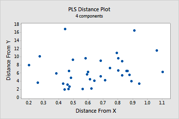

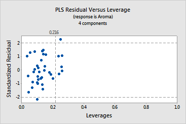

· The distance
plot and the residual versus leverage plot display outliers
and leverages. By brushing the distance plot, you can see that compared
to the rest of the data:
observations
14 and 32 have a greater distance value on the y-axis
observations
in rows 1 and 37 have greater distance value on the x-axis
The residual versus leverage plot shows that:
observation
3 is an outlier because it is outside the horizontal reference lines
observations
5, 12, 14, 23, and 37 have extreme leverage values because they are to
the right of the vertical reference line
