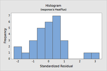

· The
histogram
indicates that outliers may exist in the data, shown by the two bars on
the far right side of the plot.

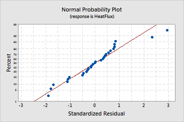

· The
normal probability plot
shows an approximately linear pattern consistent with a normal
distribution.
The two points in the upper-right corner of the plot may be outliers.
Brushing
the graph identifies these points as 4 and 22, the same points that
are labeled unusual observations in the output. See Checking
your model and Identifying outliers.

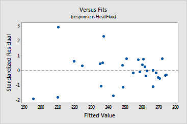

· The
plot of residuals
versus the fitted values
shows that the residuals
get smaller (closer to the reference line) as the fitted values increase,
which may indicate the residuals have non-constant variance. See [9]
