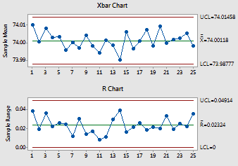

The Xbar and R Chart is located in the upper left corner of the Capability Sixpack - Normal.

Examine the image\xbar.gif-R chart or I-MR chart for points located beyond the red control limits. Points located beyond the control limits signal that the process is out of control. Capability analyses should only be conducted when the process is in control.

For the piston data, the subgroup size is 5, so an image\xbar.gif-R chart is displayed. No points are located beyond the control limits, therefore the process is in control, and further capability analyses can be conducted.
