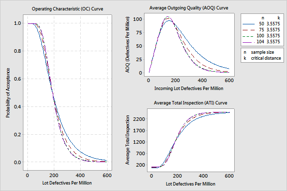

Graph window output
Graphs - Acceptance Sampling by Variables
Interpreting the results
Comparing these graphs, you can easily make a case for reducing your sample from 104 to an even 100. The probability of acceptance at the AQL and the RQL only changes by less than 0.5% (0.95 - 0.947). Also the AOQ change as well as the ATI change is minimal.
You also decide that a sample size of 50 will not protect you, the consumer, or the producer well enough. With a sample size of 50, you have a 18.7% probability of accepting a lot at the RQL (300 PPM), too high for your comfort. Also, you have a 12.7% probability of rejecting a lot that should be accepted at the AQL (100 PPM), too high for your producer.
You need to think about the scenario of sampling 75 pipes a bit more. The risks associated with the probabilities of acceptance seem reasonable, considering you had not been doing any sampling before. You also know that your supplier is working to decrease pipe thickness variability and will be doing more monitoring at his site. So you decide to call together all the parties involved and make an informed decision considering all these things. Perhaps you will choose a sample size somewhere between 75 and 100.
