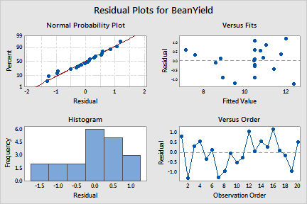

7    Under Residual Plots, choose Four in one. Click OK in each dialog box.

In addition, Minitab draws four residual plots. The residual plots do not indicate any problems with the model. For assistance in interpreting residual plots, see Residual plot choices.
