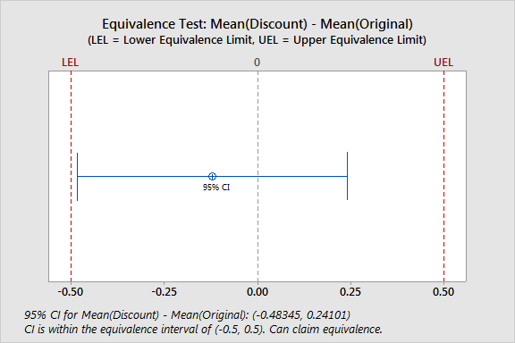

Graph window output
Interpreting the results
For the cat food data, the confidence interval for the difference is completely within the equivalence interval. Thus you can conclude that the two formulations of cat food contain equivalent amounts of protein.
