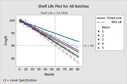

Shelf Life Estimation
Lower spec limit = 90
Shelf life = time period in which you can be 95% confident that at least 50% of response is
     above lower spec limit
Batch    Shelf Life
1            83.552
2            54.790
3            57.492
4            60.898
5            66.854
Overall      54.790

Minitab displays the shelf life estimates for each batch. The shortest shelf life estimate is 54.79 months, so the overall shelf life for the product is estimated as 54.79 months.
