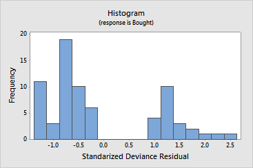

Example Output
Interpretation
For the cereal data, one group of residuals is most frequent around -0.75 and the second group is most frequent around 1.25. This pattern often means not enough data is in the set for normal approximation theory to apply. Confidence intervals for predictions are probably inaccurate.
Two observations have standardized deviance residuals that are greater in absolute value than 2.
