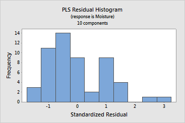

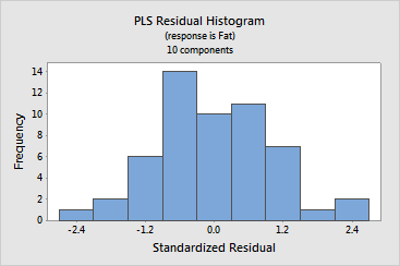

For the soybean data, there are two histograms, one for moisture and one for fat.
·    The histogram of the standardized residuals for moisture reveals possible outliers in the data, indicated by the bars on the far right side of the plot.
·    The histogram of the standardized residuals for fat reveals a bell-shaped, symmetric pattern, indicating the residuals are not skewed and there are no outliers.
