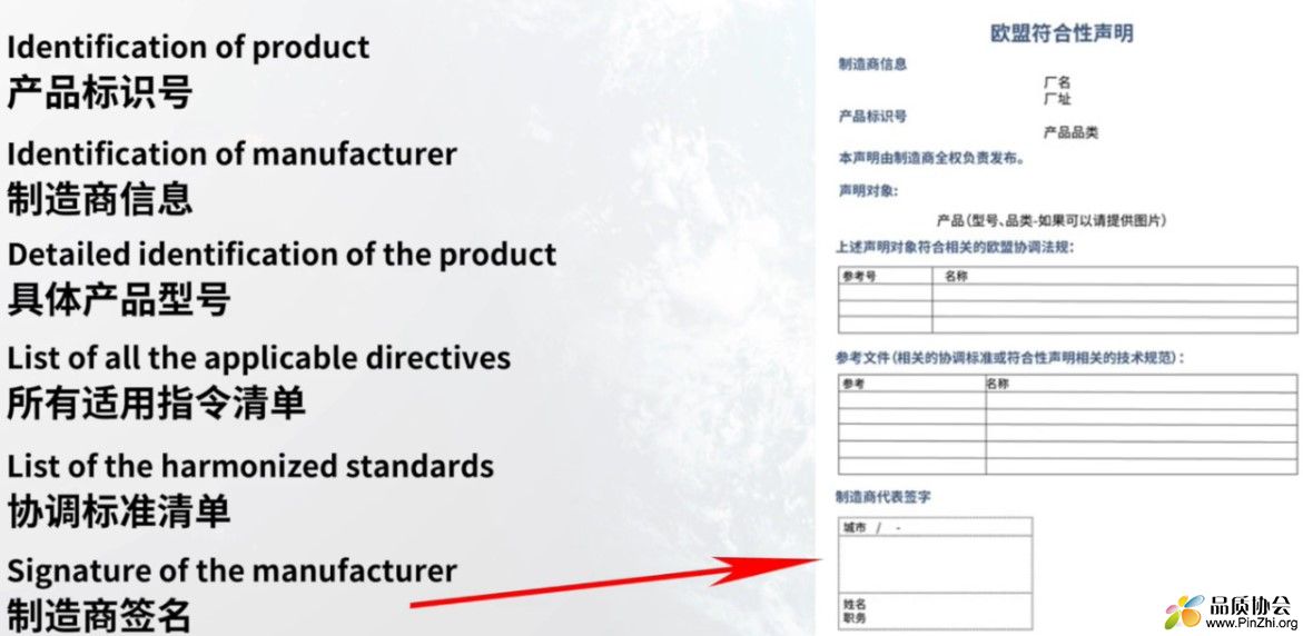

2.《符合性声明》是指制造商声明产品符合所有适用的欧盟法律法规,这是欧盟产品安全计划中最重要的文件,如果你想要在欧盟市场上销售加贴了CE标志的产品,你必须起草一份《符合性声明》,否则,销售是违法的。
The Declaration of Conformity is the manufacturer's declaration that the product complies with all applicable EU legislation and it takes full responsibility for the products.
DoC 模板:
技术文件是证明产品安全和合规性的文件汇编
