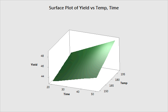

1    Open the worksheet YIELDPLT.MTW. (The design, response data, and model information have been saved for you.)
2    Choose Stat > DOE > Factorial > Surface Plot.
3    In Response, choose Yield.
4    Under Variables, in X Axis, choose Time.
5    Under Variables, in Y Axis, choose Temp.
6    Click OK.
Graph window output
Interpreting the results
The surface plot shows that Yield increases as both reaction time and reaction temperature increase. The surface plot also illustrates that the increase in yield from the low to the high level of time is greater at the high level of temperature.
