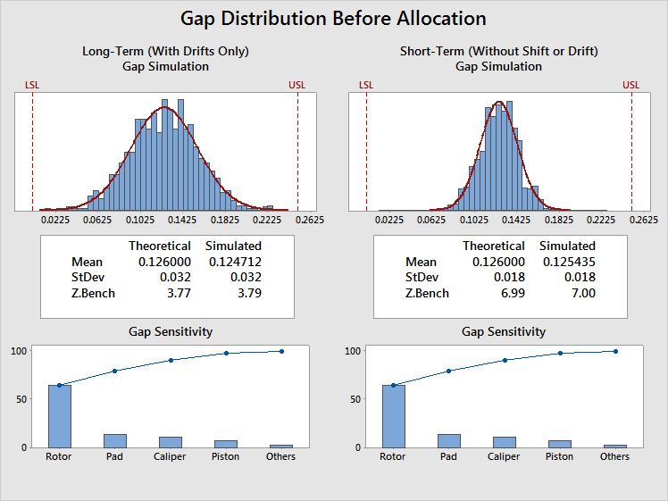

Gap Distribution Before Allocation

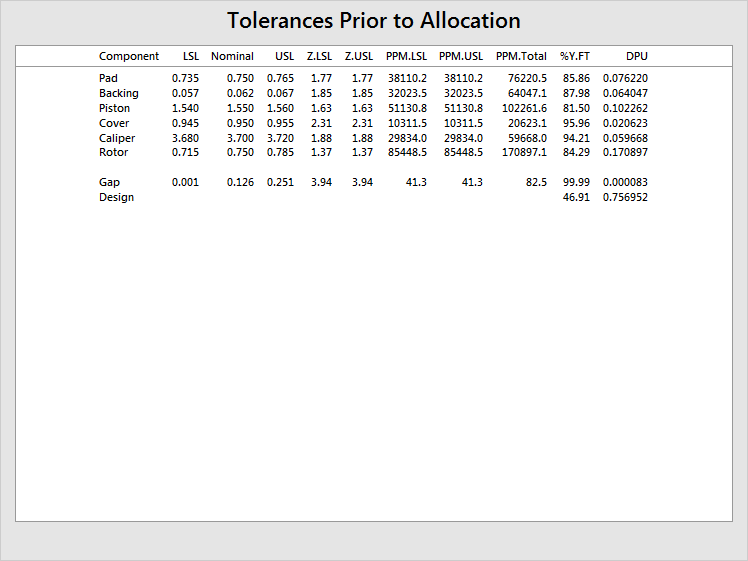

Tolerances Prior to Allocation
Graph window output
Interpreting the results
The long-term Gap Z.Bench is 3.77. However, a value of 4.5 is required in order to achieve the desired long-term PPM on the assembly Gap.
The Gap Pool Statistics table shows the gap mean and variance pools. There is no mean pool to allocate, because in this case the short-term gap mean is equal to the midpoint between the gap specification limits. When this happens, the mean pool is always equal to 0. The variance pool is -0.0002839, which means that the long-term gap variance must be reduced by 0.0002839. To accomplish this, we must perform the second stage of the analysis, the allocation stage.
