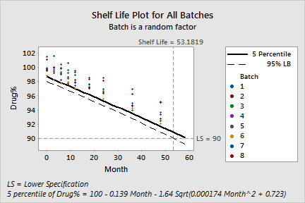

Shelf Life Estimation
Lower spec limit = 90
Shelf life = time period in which you can be 95% confident that at least 95% of response is
     above lower spec limit
Shelf life for all batches = 53.1819

When the batch factor is random, Minitab calculates shelf life based on the 95th percentile rather than the 50th percentile. (You can change this setting, and the value of alpha, in the Options subdialog box.) Shelf life is the time at which you can no longer be 95% confident that at least 95% of the response is within your specification limits. The shelf life for the present data is approximately 53.18 months.

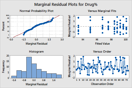

The marginal residual plots for Drug% (above) show that the marginal residuals may not be normally distributed with constant variance. The histogram is flatter than the normal distribution, and the points in the normal probability plot do not follow the line well. One reason for the nonnormal behavior of the marginal residuals is that, when the final model includes the batch by time interaction, the variance of the marginal residuals depends on the time variable and may not be constant.

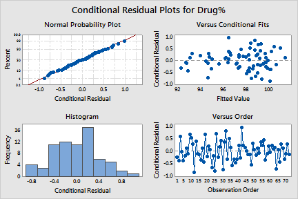

You can use the conditional residuals to check the normality of the error term in the model.
1    Press CTRL+E or choose Stat > Regression > Stability Study > Stability Study.
2    Click Graphs.
3    In Residuals for plots, choose Conditional regular.
4    Click OK in each dialog box.
Graph window output
Interpreting the results
The conditional residuals appear to be normally distributed. The full model appears to fit the data well.
