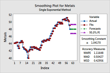

Graph window output
Interpreting the results
Minitab generated the default time series plot which displays the series and fitted values (one-period-ahead forecasts), along with the six forecasts.
In both the Session and Graph windows, Minitab displays the smoothing constant (weight) used and three measures to help you to determine the accuracy of the fitted values: MAPE, MAD, and MSD (see Measures of accuracy). The three accuracy measures, MAPE, MAD, and MSD, were 1.12, 0.50, and 0.43, respectively for the single exponential smoothing model, compared to 1.55, 0.70, and 0.76, respectively, for the moving average fit (see Example of moving average). Because these values are smaller for single exponential smoothing, you can judge that this method provides a better fit to these data.
