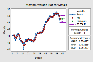

Graph window output
Interpreting the results
Minitab generated the default time series plot which displays the series and fitted values (one-period-ahead forecasts), along with the six forecasts. Notice that the fitted value pattern lags behind the data pattern. This is because the fitted values are the moving averages from the previous time unit. If you wish to visually inspect how moving averages fit your data, plot the smoothed values rather than the predicted values.
