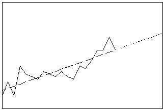

Trend Analysis
Fits a general trend model to time series data. Choose among the linear, quadratic, exponential growth or decay, and S-curve models. Use this procedure to fit trend when there is no seasonal component in your series.
Length: long
Profile: extension of trend line

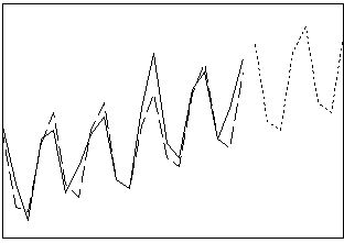

Decomposition
Separates the times series into linear trend and seasonal components, as well as error. Choose whether the seasonal component is additive or multiplicative with the trend. Use this procedure to forecast when there is a seasonal component in your series or if you simply want to examine the nature of the component parts
Length: long
Profile: trend with seasonal pattern

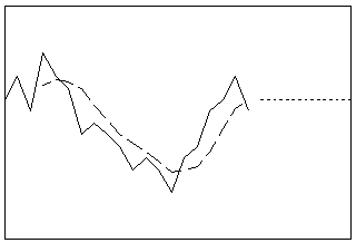

Moving Average
Smoothes your data by averaging consecutive observations in a series. This procedure can be a likely choice when your data do not have a trend or seasonal component. There are ways, however, to use moving averages when your data possess trend and/or seasonality.
Length: short
Profile: flat line

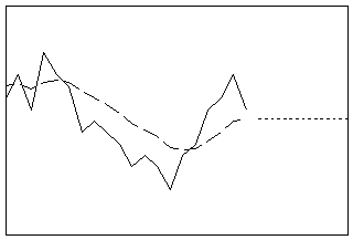

Single Exp Smoothing
Smoothes your data using the optimal one-step ahead ARIMA (0,1,1) forecasting formula. This procedure works best without a trend or seasonal component. The single dynamic component in a moving average model is the level.
Length: short
Profile: flat line

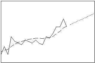

Double Exp Smoothing
Smoothes your data using the optimal one-step-ahead ARIMA (0,2,2) forecasting formula. This procedure can work well when trend is present but it can also serve as a general smoothing method. Double Exponential Smoothing calculates dynamic estimates for two components: level and trend.
Length: short
Profile: straight line with slope equal to last trend estimate

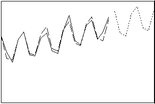

Winters' Method
Smoothes your data by Holt-Winters exponential smoothing. Use this procedure when trend and seasonality are present, with these two components being either additive or multiplicative. Winters' Method calculates dynamic estimates for three components: level, trend, and seasonal.
Length: short to medium
