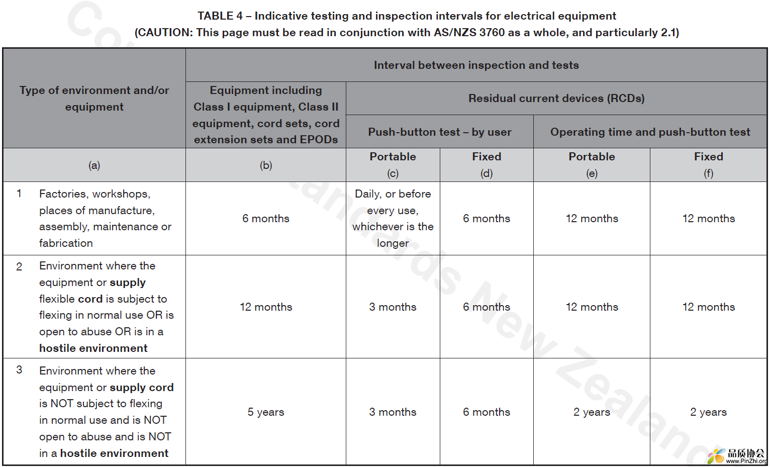

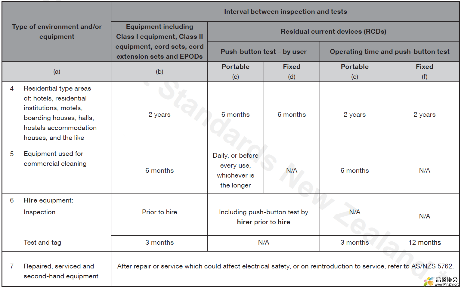

How often is it recommended to test RCDs? Is it once every 3months or 12months?

The Intervals specified under AS/NZS 3760 between tests
