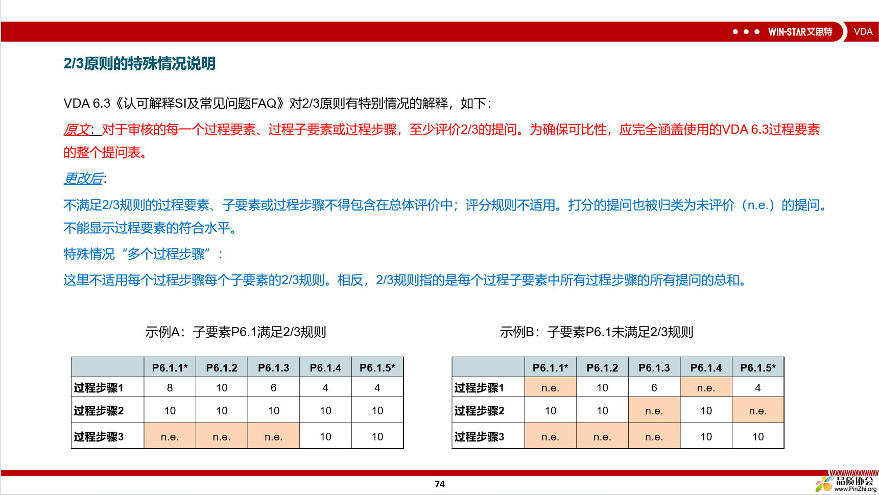

“Sanctioned Interpretations” – SI and “Frequently Asked Questions” – FAQ
Concerns Chapter 6.1 (Evaluation of the individual questions), Page 35:
At least 2/3 of the questions for each audited process element, sub-element or process step must be evaluated.
In order to ensure comparability, the entire list of questions from the VDA 6.3 process elements used should be covered in full
