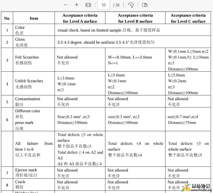

1. Purpose目的
The purpose of this document is to define clear cosmetic defects judgment criteria on different surface
forThinkpad product.
2. Scope范围
The document is consolidated and defined by PC Quality team for Thinkpad product finish goods level.
3. Definition定义
Level A appearance surface: Under normal use conditions, the product surface that is always touched by
the user, or the portions that can be directly perceived by the naked eye. As shown in the diagram below,
Level A appearance surface can be further divided into four categories:
Level A面定义:正常使用条件下,经常被用户接触并直接看到的部分,详细请参见如下示意图,Level A 面可
以进一步分为如下4类
A1 surface: When the LCD module is closed, the LCD back cover surface (where the logo is situated) that
can be seen by the user;
A1面定义:当LCD合上时,可以被用户看到的印有logo的LCD背盖面
A2 surface: When the LCD module is open to 90 degrees, the surface where the LCD screen is situated
(including the LCD screen surface and the four sides of the LCD cover);
A2面定义:当LCD被打开90度时,LCD屏幕所在面.
A3 surface: When the LCD module is open to 90 degrees, the surface where the keyboard and mouse pad
are situated in a normal use state;
A3面定义:当屏幕被打开90度时,键盘和触摸板所在平面.
A4 surface: When the LCD module is closed, the front side surface that the user faces;
A4面定义:当LCD合上时,用户可以看到的机台前面
All labels’ surface is defined as Level A except the label is pasted under removable cover and battery.
(除贴在可以移除的后盖及电池下的标签/铭牌外,所有贴在机器可视面的标签/铭牌定义为A面)
